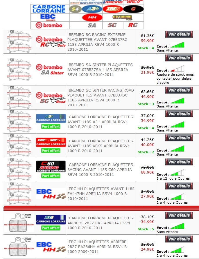

Les references CL
Carbone Lorraine type 1185
Référence             Type    Prix          usage
CL_1185-0001     XBK5    38,85 €    STREET
CL_1185-0003     A3+     33,40 €    SPORT
CL_1185-0005     C60     64,00 €    RACING
Ebuy

Aprilia OEM reference origine : 893931         € 150
Brembo
07BB37.RC     Racing Competition        € 70,95
07BB37.SC     Racing - SC sport street    € 68,30
07BB37.SA     Road - SA            € 50,27
07BB37.93    Genuine - Sinter (93)        € 85,00
Ferodo
SinterGrip XRAC 01-2218-XRAC FDB2218XRAC Racing    $ 129
ST Front Brake Pads (ex FDB2218ST) (FDB2260ST)    $ 50
SBS
841 DC        Race competition        € 52
841 DS        Race endurance            € 105
841 RS        Road Racing Metal sinterise      € 40
841 HS        Sport riding            € 32
